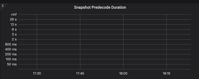

  • 观察 Grafana 中的 TiFlash-Summary 看板,Raft 中 “Applying snapshots Count”, “Snapshot Predecode Duration”, “Snapshot Flush Duration”,反映 TiFlash 通过 ApplySnapshot 接收数据的并发度、apply 耗费的时长;
TiFlash-summary -> raft -> Applying snapshots Count
TiFlash-summary -> raft -> Snapshot Predecode Duration
TiFlash-summary -> raft ->Snapshot Flush Duration
