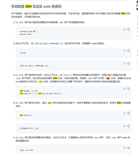

测试下 ssh 到目标机器,再看下目标机器的日志
开始ssh有问题吧,后面修复了,但是停止失败?直接scale-in 这个节点,不行就带–force,然后重新scale-out吧
scale-in –force强制缩容这个节点,再重新扩容scale-out,这样试一下是否可行
重新坐下ssh免密登陆重新扩缩容吧,最好防火墙端口都开下或者关闭。
从管理节点ssh-copy-id -i ~/.ssh/id_rsa.pub 10.173.17.4 的秘钥发送给主机10.173.17.4
互信解决了,结局之后缩容失败了
[root@10.173.17.4 ~]$ scp /root/.tiup/storage/cluster/clusters/tidb-iap/config-cache/prometheus-10.173.17.4-9090.service tidb@10.173.17.4:/tmp/prometheus_3756f0f7-4b8c-4830-b501-dc2de7372f27.service
prometheus-10.173.17.4-9090.service 100% 437 1.1MB/s 00:00
手动执行能成功,但是tiup命令执行报了这个错:
Error: init config failed: 10.173.17.4:9090: transfer from /root/.tiup/storage/cluster/clusters/tidb-iap/config-cache/prometheus-10.173.17.4-9090.service to /tmp/prometheus_3756f0f7-4b8c-4830-b501-dc2de7372f27.service failed: failed to scp /root/.tiup/storage/cluster/clusters/tidb-iap/config-cache/prometheus-10.173.17.4-9090.service to tidb@10.173.17.4:/tmp/prometheus_3756f0f7-4b8c-4830-b501-dc2de7372f27.service: ssh: handshake failed: ssh: unable to authenticate, attempted methods [none publickey], no supported methods remain
你用tidb用户安装还是用root安装的,你手工执行的scp使用的root,但是命令里是tidb用户啊,你tidb用户之间做了免密吗?
扩容命令发出来看看。
SCP有问题,手动执行一下 SCP 10.173.17.4试试
