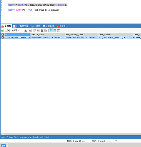

select * from table_name limit 1很慢
【 TiDB 版本】 7.1.3
tidb执行简单的select limit 1查询,很慢,没理解其中原因,表大小大概7亿左右,理论上这种sql查询速度应该很快的,类似情况多套集群都出现过

执行时间如图:

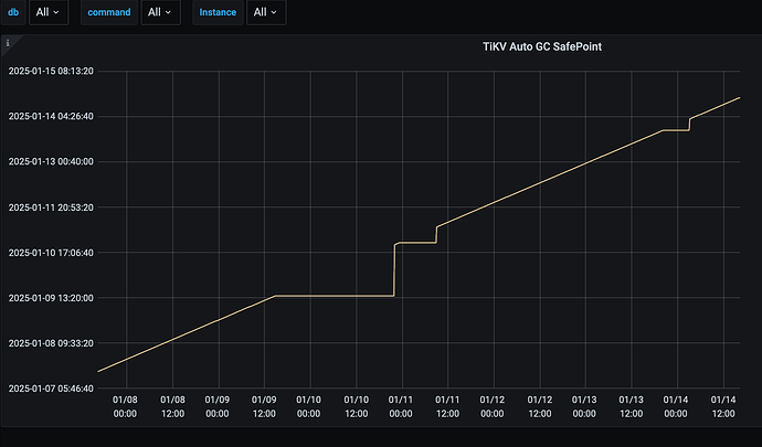

默认10分钟,gc是否正常执行了呢?

个别时间段会出现gc暂停的日志:
[2025/01/10 21:39:44.909 +08:00] [INFO] [gc_worker.go:731] [“[gc worker] there’s another service in the cluster requires an
earlier safe point. gc will continue with the earlier one”] [uuid=638e2c77c48000f] [ourSafePoint=455217193912107008] [minS
afePoint=455187913738027137]
[2025/01/10 21:39:44.909 +08:00] [INFO] [gc_worker.go:707] [“[gc worker] last safe point is later than current one.No need
to gc.This might be caused by manually enlarging gc lifetime”] [“leaderTick on”=638e2c77c48000f] [“last safe point”=2025/01
/09 14:28:09.882 +08:00] [“current safe point”=2025/01/09 14:28:09.882 +08:00]
暂时没找到到这这个gc暂停的原因
