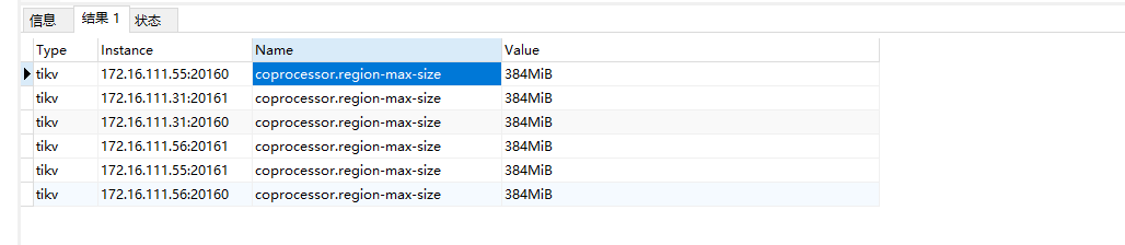

【资源配置】以下是我的参数配置
server_configs:
tidb:
log.slow-threshold: 300
performance.txn-entry-size-limit: 12582912
performance.txn-total-size-limit: 1073741824
tikv:
coprocessor.region-max-size: 384MB
coprocessor.region-split-size: 256MB
readpool.storage.use-unified-pool: true
readpool.unified.max-thread-count: 20
server.grpc-concurrency: 20
storage.block-cache.capacity: 128G
pd:
replication.location-labels:
- host
schedule.leader-schedule-limit: 4
schedule.region-schedule-limit: 2048
schedule.replica-schedule-limit: 64
