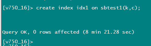

一张2亿表建索引测试
不使用分布式ddl时 执行时间和CPU如下

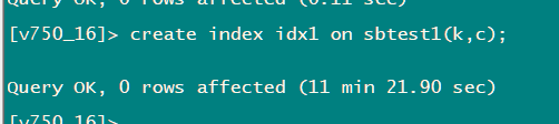

当通过调整tidb_service_scope tidb_enable_dist_task 开启并行DDL后 建索引时间反而变的更长,3个tidb节点是时间如下
从tidb cpu上看 每个tidb执行是并不像单tidb一样一直持续的执行的
ddl owner是16节点,3个节点的tidb.log 见附件
log.rar (275.3 KB)
一张2亿表建索引测试
log.rar (275.3 KB)

怀疑是写的太快导致的,能否该时间段的收集一下监控?cinic 收集方法如下: https://docs.pingcap.com/zh/tidb/stable/quick-start-with-clinic , 收集信息类型里建议包含 metric 和 log,option 是 --include=monitor,log
[2024/07/15 15:25:32.518 +08:00] [WARN] [region_job.go:532] ["meet error and handle the job later"] [category=ddl-ingest] ["job stage"=wrote] [error="[Lightning:KV:ServerIsBusy]too many sst files are ingesting"] [region="{ID=122161,startKey=7480000000000041FFF05F698000000000FF0000080380000000FF0708A84D01383530FF3830373139FF3531FF392D37303934FF36FF3133323630392DFFFF3830353338343437FFFF3337342D383237FF37FF343239323435FF352DFF3633303434FF323437FF3637342DFF35393239FF393032FF383330352DFF3638FF353932323935FF36FF37352D31303135FFFF333235383831302DFFFF34323136343631FF35FF3433302D3139FF3832FF3239323839FF383900FE03800000FF00012BBB6D000000FC,endKey=7480000000000041FFF05F698000000000FF0000080380000000FF0745460E01393533FF3433303233FF3338FF332D34303735FF32FF3936313434372DFFFF3831303532353432FFFF3230382D393339FF30FF303539353039FF312DFF3731393134FF313737FF3531392DFF38323736FF393238FF313334342DFF3334FF323930333634FF34FF30312D38313839FFFF373134323732382DFFFF34333034383236FF37FF3230352D3835FF3033FF3433383032FF313100FE03800000FF00090B61F7000000FC,epoch=\"conf_ver:30125 version:8670 \",peers=\"id:122163 store_id:1 ,id:122299 store_id:3 ,id:122300 store_id:8007 \"}"] [start=7480000000000041F05F69800000000000000803800000000708A84D013835303830373139FF3531392D37303934FF363133323630392DFF3830353338343437FF3337342D38323737FF343239323435352DFF3633303434323437FF3637342D35393239FF393032383330352DFF3638353932323935FF3637352D31303135FF333235383831302DFF3432313634363135FF3433302D31393832FF3239323839383900FE0380000000012BBB6D] [end=7480000000000041F05F6980000000000000080380000000071AC7EB013939353232353837FF3836392D30393234FF383831373634372DFF3231363932383931FF3236362D38313731FF353430343735372DFF3530323634333937FF3633392D31333639FF313234343636332DFF3037353836323438FF3837312D37323532FF343334363233372DFF3538353930383036FF3834342D34363939FF3633373530313300FE038000000009DD3F84]
[2024/07/15 15:25:32.518 +08:00] [INFO] [local.go:1461] ["put job back to jobCh to retry later"] [category=ddl-ingest] [startKey=7480000000000041F05F69800000000000000803800000000708A84D013835303830373139FF3531392D37303934FF363133323630392DFF3830353338343437FF3337342D38323737FF343239323435352DFF3633303434323437FF3637342D35393239FF393032383330352DFF3638353932323935FF3637352D31303135FF333235383831302DFF3432313634363135FF3433302D31393832FF3239323839383900FE0380000000012BBB6D] [endKey=7480000000000041F05F6980000000000000080380000000071AC7EB013939353232353837FF3836392D30393234FF383831373634372DFF3231363932383931FF3236362D38313731FF353430343735372DFF3530323634333937FF3633392D31333639FF313234343636332DFF3037353836323438FF3837312D37323532FF343334363233372DFF3538353930383036FF3834342D34363939FF3633373530313300FE038000000009DD3F84] [stage=wrote] [retryCount=1] [waitUntil=2024/07/15 15:25:34.518 +08:00]

inject sst 失败的原因是写的太快导致了 L0 的文件太多了,然后 inject 就失败了,
相关的 tikv 代码如下:
建议适当的降低 tidb_ddl_reorg_worker_cnt
和 tidb_ddl_reorg_batch_size
减少写压力来减少 retry。
另外,如果瓶颈在 tikv 上,分布是 ddl 并不比非分布 ddl 快,这个符合理论预期的。
