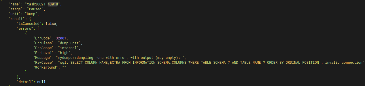

dm执行报错 :invalid connection
执行报错:
“ErrCode”: 32001,
“ErrClass”: “dump-unit”,
“ErrScope”: “internal”,
“ErrLevel”: “high”,
“Message”: "mydumper/dumpling runs with error, with output (may empty): ",
“RawCause”: “sql: SELECT COLUMN_NAME,EXTRA FROM INFORMATION_SCHEMA.COLUMNS WHERE TABLE_SCHEMA=? AND TABLE_NAME=? ORDER BY ORDINAL_POSITION;: invalid connection”,
“Workaround”: “”
后端日志也是如此
前后端的连接是正常的 我能看到前端执行的sql语句 以及后端用户的连接
偶发性的有如下报错
重启过任务 也没效果
