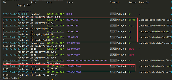

【TiDB 版本】v6.5.0
【操作系统】CentOS Linux release 7.9
【部署方式】云下本地机房部署
【集群数据量】1个
【集群节点数】5个节点
【问题复现路径】机房意外断电,集群宿主机服务器宕机后,重启整个tidb集群,发现2个tidb-server和1个tikv启动失败。
1、tidb的错误日志如下:
[2025/10/13 15:23:46.399 +08:00] [FATAL] [terror.go:300] ["unexpected error"] [error="[tikv:9005]Region is unavailable"] [stack="github.com/pingcap/tidb/parser/terror.MustNil\n\t/home/jenkins/agent/workspace/build-common/go/src/github.com/pingcap/tidb/parser/terror/terror.go:300\nmain.createStoreAndDomain\n\t/home/jenkins/agent/workspace/build-common/go/src/github.com/pingcap/tidb/tidb-server/main.go:315\nmain.main\n\t/home/jenkins/agent/workspace/build-common/go/src/github.com/pingcap/tidb/tidb-server/main.go:214\nruntime.main\n\t/usr/local/go/src/runtime/proc.go:250"] [stack="github.com/pingcap/tidb/parser/terror.MustNil\n\t/home/jenkins/agent/workspace/build-common/go/src/github.com/pingcap/tidb/parser/terror/terror.go:300\nmain.createStoreAndDomain\n\t/home/jenkins/agent/workspace/build-common/go/src/github.com/pingcap/tidb/tidb-server/main.go:315\nmain.main\n\t/home/jenkins/agent/workspace/build-common/go/src/github.com/pingcap/tidb/tidb-server/main.go:214\nruntime.main\n\t/usr/local/go/src/runtime/proc.go:250"]
2、tikv的错误日志如下:
025/10/13 15:22:57.869 +08:00] [INFO] [engine.rs:91] ["Recovering raft logs takes 9.924494026s"]
[2025/10/13 15:22:58.814 +08:00] [ERROR] [engine_factory.rs:164] ["failed to create kv engine"] [err="Engine(Status { code: IoError, sub_code: None, sev: NoError, state: \"IO error: While renaming a file to /acdata/tidb-data/tikv-20163/db/CURRENT: /acdata/tidb-data/tikv-20163/db/26226887.dbtmp.plain: Structure needs cleaning\" })"] [path=/acdata/tidb-data/tikv-20163/db]
[2025/10/13 15:22:58.814 +08:00] [FATAL] [server.rs:1828] ["failed to create kv engine: Storage Engine Status { code: IoError, sub_code: None, sev: NoError, state: \"IO error: While renaming a file to /acdata/tidb-data/tikv-20163/db/CURRENT: /acdata/tidb-data/tikv-20163/db/26226887.dbtmp.plain: Structure needs cleaning\" }"]
tidb-server一共有2个节点,均无法启动。tikv节点有2个,1个可以正常启动,另一个无法启动。

2个kv节点是怎么部署的? 单副本?pd节点状态是什么?
tidb-server是无状态的,可以重新部署。无法启动是指启动失败还是反复重启?
tikv 2个节点?数据是单副本的吗?

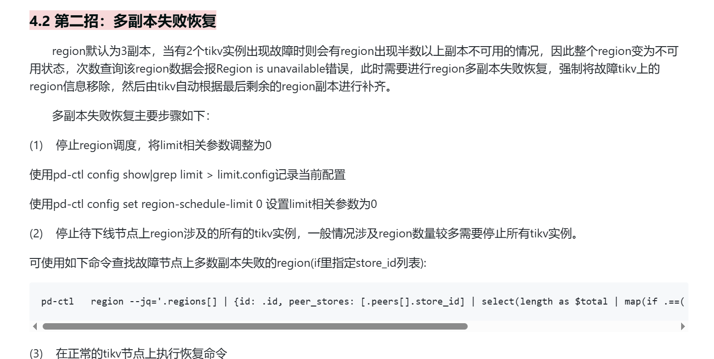

需要做 online unsafe recovery 了,有数据丢失了,参考:https://docs.pingcap.com/zh/tidb/stable/online-unsafe-recovery/#online-unsafe-recovery-使用文档
你的集群很奇怪 4 PD、2 TiKV,2 TiKV、2 副本不是正确使用 tidb 的姿势,这个跟 Mysql 不一样
看起来你这个有次节点文件损坏,但是两副本又导致必须要全部没问题才可以,没有容错。
