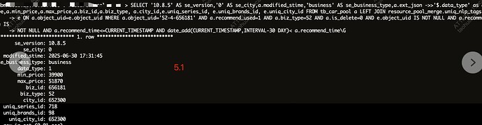

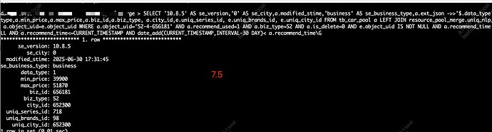

使用Python, 及原生的mysql 客户端,查询TiDB5.1/TIDB7.5结果都是相同的,不存在研发反馈的问题。
MySQL:
Python:
SQL="SELECT ‘10.8.5’ AS se_version,‘0’ AS se_city,a.modified_stime,‘business’ AS se_business_type,a.ext_json ->>‘$.data_type’ as data_type FROM tb_car_pool a LEFT JOIN resource_pool_merge.uniq_nlp_tags e ON a.object_uid=e.object_uid WHERE a.object_uid=‘52-4-656181’ AND a.recommend_used=1 AND a.biz_type=52 AND a.is_delete=0 AND e.object_uid IS NOT NULL AND a.recommend_time IS NOT NULL AND a.recommend_time<=CURRENT_TIMESTAMP AND date_add(CURRENT_TIMESTAMP,INTERVAL-30 DAY)< a.recommend_time "
cursor1.execute(SQL)
rows1 = cursor1.fetchone()
cursor2.execute(SQL)
rows2 = cursor2.fetchone()
rows1
{u’se_business_type’: u’business’, u’se_version’: u’10.8.5’, u’data_type’: u’1’, u’se_city’: u’0’, u’modified_stime’: datetime.datetime(2025, 6, 30, 17, 31, 45)}
rows2

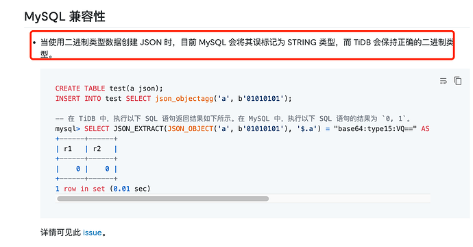

1)有类似事件
已打开 12:50PM - 29 Aug 22 UTC
已关闭 07:18AM - 31 Aug 22 UTC
type/enhancement
component/json
## Enhancement
In the mysql 5.7 `mysql-server/sql/item.cc: Item::save_in_fiel… d_inner`, it transformed the JSON into the string, and stored it in the field:
```cpp
String *result;
const CHARSET_INFO *cs= collation.collation;
char buff[MAX_FIELD_WIDTH]; // Alloc buffer for small columns
str_value.set_quick(buff, sizeof(buff), cs);
result=val_str(&str_value);
if (null_value)
str_value.set_quick(0, 0, cs);
return set_field_to_null_with_conversions(field, no_conversions);
/* NOTE: If null_value == FALSE, "result" must be not NULL. */
field->set_notnull();
type_conversion_status error=
field->store(result->ptr(),result->length(),
field->type() == MYSQL_TYPE_JSON ? result->charset() : cs);
return error;
During this procedure, the opaque information is lost, the MySQL cannot distinguish the opaque value and string value anymore. It causes the confusing behavior:
```sql
create table test (a json);
insert into test select json_objectagg('a', b'01010101');
select json_type(json_extract(a, '$.a')); -- returns STRING
select json_type(json_extract(json_object('a', b'01010101'), '$.a')); -- returns BIT
Through the two json values are constructed in the same way, they have different behavior before and after storing to the disk. This confusing behavior results in the incompatibility of following SQLs:
```sql
select * from test where json_extract(a, '$.a') = "base64:type16:VQ==";
TiDB gives empty set (as the json opaque is never equal with the json string), but MySQL will give the inserted row. Instead, consider the following example:
```sql
select * from test where json_extract(a,'$.a') = json_extract(json_object('a', b'01010101'), '$.a');
The TiDB will give a row, but the MySQL will not. (After fixing the problems in https://github.com/pingcap/tidb/issues/37435, because this function will also lose the charset / collate information :cry: )
I don't know whether we should be compatible with MySQL in this case, because the current behavior (after fixing #37435) of TiDB sounds much more reasonable.
