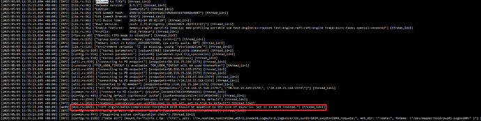

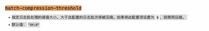

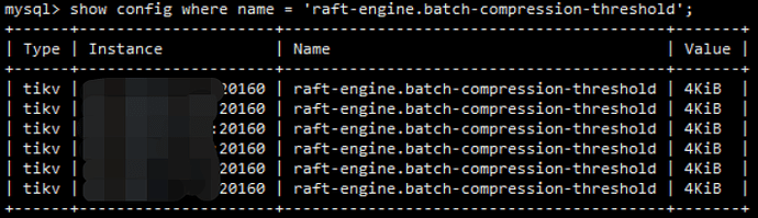

【问题复现路径】v7.5.0升级至v8.5.1,集群参数raft-engine.batch-compression-threshold默认值8K

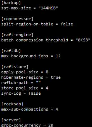

在tikv的配置文件中,强制指定参数值为8K,仍然会在启动过程中出现以下日志被自动调整回4K
[2025/05/05 11:35:15.896 +08:00] [WARN] [mod.rs:2028] [“raft-engine.batch-compression-threshold 8KiB should be adpative to the size of async-io. Set it to 4KiB instead.”] [thread_id=1]
